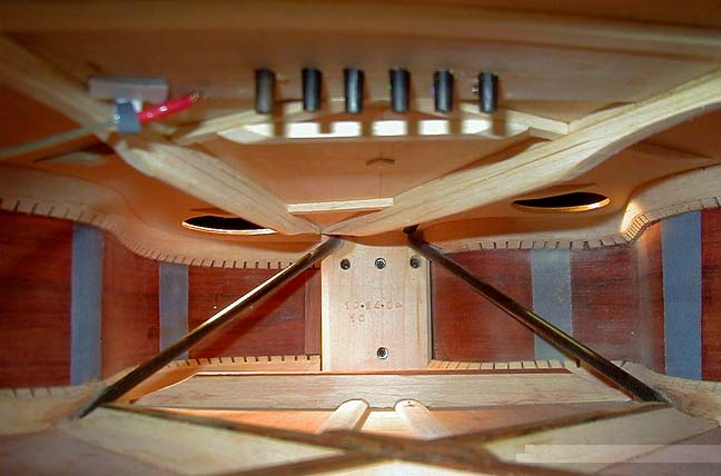

The bias tape that I get is folded, and when I un-wrap it and iron it flat it's about 1 inch wide. I'm sure that you could use regular Ar glue with it as well, I just like the hide glue better. It soaks the ribbon well and looks nice when it dries.
Here is the only picture I could find, it will probably inspire more questions than is helpful. <G> It's an inside shot of a "prototype' guitar that I kept for myself, and it has a lot of experimental things in it. The only bias tape I could find was this wierd blue colored stuff, and for my own guitar I didn't care- so it shows up real well in this picture. The blue wouldn't look so odd against a wood of a different color, but that paduak really makes it stand out!
Mark Swanson
Swanson Guitars

[QUOTE=Mark Swanson] I use the ribbon, Al Carruth turned me on to that. I like it, and find no troubles at all and it'll stop any crack just as well.
Doesn't Al also coat the stip, when installed, with shellac to safeguard the integrity of the hide glue?
Wondering if you also use this step Mark?
